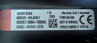

It means that changes made by the BIOS update broke the compability. Is the Hyper X on the support list? Could you provide us with the SKU of the Hyper X set? SKU is that long array of letters and numbers that does not make sense at first glance.
