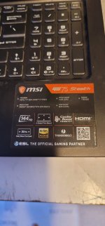

This laptop, GS75 Stealth 9SF-243US-BB7975H16GXXDX10MA It set for a long time and now I can not make it boot up, I plugged it in overnight, When I press the power button the red light comes on, I do not see any other lights and I hear the fan running. The screen does nothing. I found the reset hole so this is next
