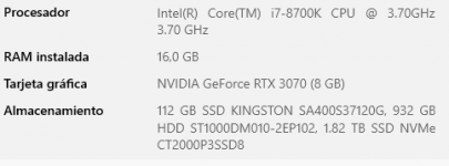

Any help will do. Here are my specs:

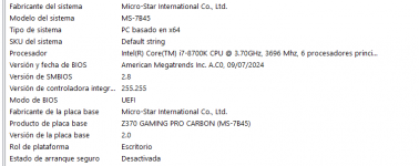

our computers be almost twins, and in the same trouble :S.. disk be at gpt, bios updated.. idk i check aa few things before, and nothing solve my black screen after enable secure boot...

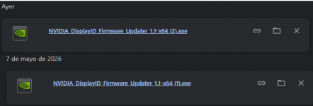

Same for you, check the NVIDIA updater first. If that says that an update is available, then that has a chance of helping.
Example screen:
