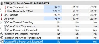

Here we also see that the two configurations with DC/LLC=110 + an offset see much lower max power draw spikes compared to the LL5 preset and the DC=LLC=68 + offset modes. LL5 has the highest average VCore, while the VCore spikes are within 10mV range across the four configurations.
Scores were within margin of error, around 2990 pts for single core and 19680 pts for multi core.
The win goes to config B for having the lowest metrics across the board.
