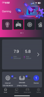

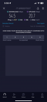

Hey I’m having problems with my router it’s not making my wifi any better like it said it’s stuck on 50mps any suggestions?
