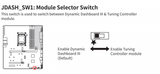

Apologies, my dynamic dashboard error is actually on the z890 intel platform, but I haven't seen it mentioned thus far. Does anyone know what this error means? There is nothing in the manual or online about it! I've got the latest FW and Data using the update tool and it displays this from the moment the system boots. It was displaying thermal data initially, but I didn't see the moment it stopped working...View attachment 209105
Check the switch position of the JDASH_SW1 on the board. Manual pages 65 and 75.
