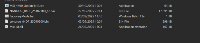

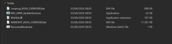

The software is clearly doing something wrong. When it initially runs, it detects that the AMD firmware is present and that it is configured to flash a new AMD firmware, but then.flashed the Intel version, rechecks, sees a mismatch and won’t continue the reflash. I will upload the log when I get home.
So, how did I fix this? I went onto the Z890 webpage, installed the Z890 recovery tool but copied over the AMD firmware and data file to the Z890 folder and renamed the files to Intel version. Ran the Z890 tool, which saw a match, it then flashed the renamed AMD firmware and data back into the EZ-bridge, but on recheck saw the mismatch and refused the rest of the procedure. I then went back to the AMD software, skipped the recovery process and just did the firmware update, and got the EZ-bridge up to date with the correct AMD firmware.
The debug code and the CPU and ChipA temps are working again, but the main screen is still down.
I’m starting RMA #2 for just the EZ bridge.
That is so weird. The Z890 and the X870E flash tools have different files. The .exe is the same but the .bin files are different.
Why is it weird or let alone so weird? They are likely same devices but they need to interact with two different motherboard and chipsets, so they have different firmwares. Makes perfect sense.
This was a response to @waltersw156502d9 who somehow got the Intel firmware onto his AMD board, despite the downloads being different files.
It makes sense to me but clearly not to you...
