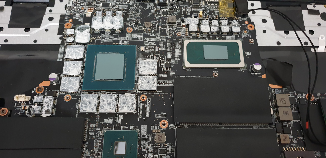

My laptop with cutted PTM pads on cpu and gpu:
I have both, but for now i use only pads.
Pads is same like paste but is "ready to go" and have always 0,2mm thickness. Pads dissolve at 45℃. Normal PTM paste requires drying (1 hour) after application before mounting cooling system.
