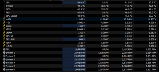

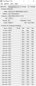

1) Test which power limits you need to set for your cooling. One way is to eyeball a number that your cooler might be able to handle comfortably (with a good tower cooler, we could say 180W for example), you set those power limits in the BIOS for a test, then you check how high the temperatures get under fully multithreaded load. If they are now in the mid-80°C range, that's good, you found your cooler's potential and you have some headroom left for higher ambient temperatures in the summer. If you still run into thermal throttling, you set the limits a bit lower.
To test the limits, check your sensors with HWinfo after ten minutes of full CPU load. Run HWinfo and open "Sensors", then expand all sensors by clicking on the little <--> arrows on the bottom, also expand the columns of the sensors a bit so everything can be read. Make it three big columns of sensors (or four, if the screen resolution is high enough). In the end, it should be a screenshot with all the sensors visible at once, like this:
Always make sure your power plan in Windows is set to "Balanced", this is the only proper one. Leave the PC in idle for a a minute or two first to establish the "minimum" baselines for the values. Then, produce full CPU load with Cinebench (either R24 or the still-more-popular R23) by running the "CPU Multi" benchmark, and after completing a 10 minute run, when the CPU temperatures have stabilized at the highest level, check the score and the HWinfo sensor window.
Example of a Cinebench R23 run, leave HWinfo Sensors open in the background.
What are we looking at in HWinfo after the Cinebench run?
Mostly these values in the "Maximum" column (the highest recorded values during monitoring):
Now, this is from my own system, using one of the best air coolers around (Noctua NH-D15), and only using a i5-13500, which i managed to also lower the voltage (and thus power draw), we will come to that as well in step 2) below. The result is that, even under full load, i have a pretty quiet system, and in idle, i don't even hear if it's on or not. Also, it's staying well clear of any dangerous temperatures under full load, thanks to less than 110W of power draw. It doesn't get any better than that: The cooler is overkill for the CPU, so everything can be set to run very quietly, and there is no stress on anything whatsoever. I can leave the power limits maxed out in the BIOS (4096W), because the power draw is so low, and this is very far away from >90°C temperatures which would be thermal throttling territory.
But for most people it will look a bit different at first, especially with higher CPU models that draw more power. Once there's a 14th gen i7 or i9 in there, it will absolutely gulp down the electricity, we're talking 300+ Watts easily under full load (also see here). The power draw of the higher-end CPU models has gotten completely out of hand (quite similar to high-end GPUs).
So for a lot of CPUs, the power limits have to be set according to what your cooling can handle. Otherwise it may look like this:
This PC actually crashed after a couple seconds (in hindsight, surely having to do with the stability issues on 13th/14th gen), but just before it crashed, it managed to draw 322W and immediately cause thermal throttling from hell. Even a nice 360mm AIO cooler cannot deal with this kind of heat.
After setting 253W power limits and improving the cooling setup a bit, this was the result:
No thermal throttling anymore, but still too high temperatures, there should be some headroom for higher ambient temperatures. If the CPU temperature is mid-80°C, perfect. Above 90°C, you should reduce the power limits, below 80°C you can raise them if you want, of course it also depends on the noise you want to tolerate, that has to do with the fan curves. It's certainly worth checking if the fan curves are set properly (low fan speeds in idle, slowly ramping up with higher temperatures, full speed at around 90°C). I would try to stay away from the 90°C range CPU temperatures under full load, because as mentioned, that slowly enters thermal throttling territory. It is not good to rely on that, and when it's hot in the summer and the cooler has to work with warmer ambient air, it can more easily run into thermal throttling. So there needs to be some thermal headroom to account for that.
