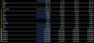

Example of a Cinebench R23 run, leave HWinfo Sensors open in the background.
What are we looking at in HWinfo after the Cinebench run?
Mostly these values in the "Maximum" column (the highest recorded values during monitoring):
Now, this is from my own system, using one of the best air coolers around (Noctua NH-D15), and only using a i5-13500, which i managed to also lower the voltage (and thus power draw), we will come to that as well in step 2) below. The result is that, even under full load, i have a pretty quiet system, and in idle, i don't even hear if it's on or not. Also, it's staying well clear of any dangerous temperatures under full load, thanks to less than 110W of power draw. It doesn't get any better than that: The cooler is overkill for the CPU, so everything can be set to run very quietly, and there is no stress on anything whatsoever. I can leave the power limits maxed out in the BIOS (4096W), because the power draw is so low, and this is very far away from >90°C temperatures which would be thermal throttling territory.
But for most people it will look a bit different at first, especially with higher CPU models that draw more power. Once there's a 14th gen i7 or i9 in there, it will absolutely gulp down the electricity, we're talking 300+ Watts easily under full load (also see here). The power draw of the higher-end CPU models has gotten completely out of hand (quite similar to high-end GPUs).
So for a lot of CPUs, the power limits have to be set according to what your cooling can handle. Otherwise it may look like this:
This PC actually crashed after a couple seconds (in hindsight, surely having to do with the stability issues on 13th/14th gen), but just before it crashed, it managed to draw 322W and immediately cause thermal throttling from hell. Even a nice 360mm AIO cooler cannot deal with this kind of heat.
After setting 253W power limits and improving the cooling setup a bit, this was the result:
No thermal throttling anymore, but still too high temperatures, there should be some headroom for higher ambient temperatures. If the CPU temperature is mid-80°C, perfect. Above 90°C, you should reduce the power limits, below 80°C you can raise them if you want, of course it also depends on the noise you want to tolerate, that has to do with the fan curves. It's certainly worth checking if the fan curves are set properly (low fan speeds in idle, slowly ramping up with higher temperatures, full speed at around 90°C). I would try to stay away from the 90°C range CPU temperatures under full load, because as mentioned, that slowly enters thermal throttling territory. It is not good to rely on that, and when it's hot in the summer and the cooler has to work with warmer ambient air, it can more easily run into thermal throttling. So there needs to be some thermal headroom to account for that.
With a lot of CPU models, not much performance will be lost from setting power limits (unless they are very low). That is because above a certain power draw, the performance increase will be in the low- to mid-single-digits, while power draw will rise pretty much exponentially. So these last performance gains are to be dismissed anyway, they are highly ineffective "junk performance". You are improving the calculation efficiency by limiting the power draw a bit, because there will be less energy spent for the job to finish.

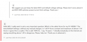

So, with Auto/Default/Stock MSI/Intel Settings, I'm 100% safe for 10 years + ? Or do I really need to choose a lower CPU Lite Load Preset in my
MAG Z790 TOMAHAWK WIFI DDR4 ?​
A 14900K is always going to use high voltages to reach its high clocks, that wasn't the issue. The dangerous part, or more precisely, the damaging part, was regarding bugs in the older microcode which lead to periodic spikes of high voltage (well past 1.5V), literally "chipping away" at parts of the CPU on a molecular level, leading to degradation and instability over time. So with the latest microcode, the vast majority of voltage spike issues are fixed, and CPU should last a long time again without becoming unstable later.
This guide here then is not mainly about fixing the voltage spikes, the latest BIOS versions already take care of that. The guide is about the fact that CPUs like the 14900K are absolute monsters, with crazy high power draw and resulting high temperatures, as well as lack of efficiency. In step 1), you make sure that under full CPU load (such as what Cinebench R23 creates), the cooler can handle the heat, instead of relying on thermal throttling (an emergency mechanism to save the CPU from a heat death). In step 2), you try to gain some efficiency by modifying a setting according to the quality of your individual CPU (which is normally set on a default that is too high, needlessly costing efficiency).
So while the CPU is safe from early degradation now, it's by no means optimized yet. By doing this according to the guide, you can still get vast improvements in how it runs.
Also, what is CEP and CEP for 14 Gen ? Do I need those to be turned off ( Disabled ) in bios ?
Well, as safe as you can be, not even Intel will guarantee anything at this point. Normally, instead of buying the most high-end part of the time and trying to use it for over a decade, it can make more sense to get a mid-range part and plan with slightly more frequent updates (let's say every 6-8 years). Because not only do the high-end parts have the biggest profit margin, they are nowadays also pushed too far to the limit from factory. So for example, i would almost always recommend the i7 over the i9, similar for board models or GPU models, i wouldn't really recommend the highest-end one, they tend to have the worst price/performance ratio and so on.
But considering what you have now, you are as safe as you can be at this time. However, i would still advise to check for further BIOS updates. It's possible that Intel find another edge case where there can be voltage spikes, which will require another microcode update, which later gets implemented into a newer BIOS version by MSI. Of course, microcode updates are not unusual, Intel regularly release new revisions of it, but i'm talking specifically about ones that may fix further voltage spike issues.
Well, i'd advise it, because it can vastly improve how your CPU runs over the next decade or so. Lower power draw -> less heat -> lower temperatures -> better efficiency. Of course, how much you can lower that setting depends on your CPU's individual quality, but i wouldn't leave those improvements unutilized. The default setting that MSI chose here is unnecessarily high for most CPUs out there, only few of them need such a high mode.
Yes, beyond a certain point of lowering the mode. Once you disable IA CEP Support, the second one (for 14th gen) should also disable itself, if not, do it manually. Otherwise, when those settings kick in, your performance goes down the drain.

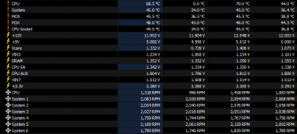

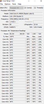

Alright, I went to bios, and I ONLY changed CPU Lite Load, from Auto to Mode 11. Now I'm playing Elden Ring and I have constant 1.380V Vcore sometimes 1.360V Vcore and 227W max, it doesn't want to go up to 253W anymore. Compared to before Everything Auto/Default Settings 1.450V-1.477V Vcore and maximum of 1.496V. Now I have maximum of 1.442V. I'm 100% safe now ? ( I'm still using Intel Default Settings, like I said, I ONLY changed CPU Lite Load Mode from Auto to Mode 11 !

You can ditch HWmonitor and Core Temp, HWinfo 64 does it all, and better.
Mode 11 is a "safe bet", seeing how Mode 9-12 were the defaults for many board/CPU combinations before, in older BIOS versions. It's only in recent BIOS versions they have set higher default modes, potentially hoping to stabilize CPUs which have already suffered from deterioration.
So if you don't want to do much testing, Mode 11 is something you can set with relative safety, most CPUs should still be ok at that mode (meaning, perfectly stable). However, i would try to see what your CPU is really capable of. As in, lower the mode some more and run stress tests like Prime95, OCCT etc., to see where you can spot the first little instability. Then, obviously, increase the mode again by one step, and throroughly test that step (so instead of just a quick stress test, you can test that one for an hour or so). If it turns out to be fully stable, then you increase it by one more step, just to be on the safe side.
If you randomly stop at Mode 11, this is much better than the default, and you don't have to worry much about stability. However, you leave free untapped improvements on the table. Who knows, your CPU might still be happy at Mode 6 or so. It's worth exploring. The stress tests make it quite easy. They will spot even a small instability with the CPU by stressing it much more than any normal program would.

Well, a few days ago I contact MSI Support regarding this question, and I will attach a screenshot with their answer :)
If you are worried about high voltages (unrelated to damaging voltage spikes which were because of microcode bugs), then you should get an i7 at the most, if not an i5. Due to their lower frequencies combined with fewer cores, they run at a much more relaxed state than an i9. The i9, ever since the i9-9900K in 2018, has always been pushed very far from factory.
But apart from the voltage spike bugs, Intel actually designed it like this. It's quite crazy to push it that far, but they felt it was necessary to be able to compete with AMD's top CPUs at the time. So in a way, MSI are not really wrong when they suggest that this is how it was meant to be, more or less. What they are wrong about is the BIOS using "optimized" settings, especially for the power limits. The power limits are the same for everyone with this CPU, wether they foolishly slap a cheap tower cooler on there, or a high-end 420mm AIO or custom loop. So if you use the same power limit for both scenarios, of course it's not gonna fit well for either one. These settings have to be found out for each system individually if you want to set something proper.
Similar with the CPU Lite Load setting, which influences the voltages. Often times you can optimize it down a lot. So why rely on some defaults, which they just happened to raise a lot in the latest BIOS versions, to somewhat control a mess with already deteriorated CPUs? If your CPU isn't deteriorated, the defaults are too high most of the time. So again i would find out the right settings individually, only then is really optimized. The default BIOS settings, not much is "optimized", this i can guarantee.

Hello again, guys :) I changed CPU Lite Load from Mode 11 to Mode 7, and I set both IA CEP and IA CEP for 14th Gen from Auto to Disabled :) Now the Vcore stays consistently below 1.350V, with a maximum (spikes) of 1.406V :) At first, I thought, "Maybe I don't need to disable IA CEP and IA CEP for 14th Gen," but I saw a lot of comments on forums and YouTube saying that anyone who wants to undervolt should disable them for maximum gaming performance. :) I'm still getting 5.7GHz on the P-Cores in gaming and 6.0GHz in idle, with 4.4GHz on the E-Cores. :) This is amazing. Seriously, thank you, guys <3
