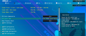

After the update, upon first entering the BIOS again, it will show the revised cooler selection screen (which is really the power limit selection screen):
Usually you can choose the middle option, no matter if your CPU would natively want to draw more power (like an i9 would) or less power (like an i5 would). Because this middle option happens to have the maximum values i would allow for any CPU (even an i9), so it's a good basis to work off of, and lower the power limits if necessary. Meaning, if there is any thermal throttling with those limits, they have to be optimized to the individual cooling capabilities, which i will shortly explain.
Note: The BIOS first has the values for the first option "Intel Default Settings" loaded. So after the middle option is selected, press F10 to save and exit, then the "MSI Performance Settings" are applied. Now there are 253W power limits set for the CPU (together with a 400A CPU Current limit), and in the first step, we now test what power limits are actually required for the temperatures to stay reasonable.
Should there be no cooler selection screen after the update, then that setting can be found here, under OC:
Again, the middle preset (nowadays it should be called "MSI Performance", that screenshot is from an older BIOS version where it was still called Boxed/Tower/Water cooler) is the correct one to work off of, meaning, to further lower the power limits from if necessary. Because the >200W limits this preset will allow can already overpower a lot of CPU coolers.

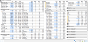

Example of a Cinebench R23 run, leave HWinfo Sensors open in the background.
What are we looking at in HWinfo after the Cinebench run?
Mostly these values in the "Maximum" column (the highest recorded values during monitoring):
Now, this is from my own system, using one of the best air coolers around (Noctua NH-D15), and only using a i5-13500, which i managed to also lower the voltage (and thus power draw), we will come to that as well in step 2) below. The result is that, even under full load, i have a pretty quiet system, and in idle, i don't even hear if it's on or not. Also, it's staying well clear of any dangerous temperatures under full load, thanks to less than 110W of power draw. It doesn't get any better than that: The cooler is overkill for the CPU, so everything can be set to run very quietly, and there is no stress on anything whatsoever. I can leave the power limits maxed out in the BIOS (4096W), because the power draw is so low, and this is very far away from >90°C temperatures which would be thermal throttling territory.
But for most people it will look a bit different at first, especially with higher CPU models that draw more power. Once there's a 14th gen i7 or i9 in there, it will absolutely gulp down the electricity, we're talking 300+ Watts easily under full load (also see here). The power draw of the higher-end CPU models has gotten completely out of hand (quite similar to high-end GPUs).
So for a lot of CPUs, the power limits have to be set according to what your cooling can handle. Otherwise it may look like this:
This PC actually crashed after a couple seconds (in hindsight, surely having to do with the stability issues on 13th/14th gen), but just before it crashed, it managed to draw 322W and immediately cause thermal throttling from hell. Even a nice 360mm AIO cooler cannot deal with this kind of heat.
After setting 253W power limits and improving the cooling setup a bit, this was the result:

Here is an example of what a user set for their specific configuration in the BIOS:
Now, this is just to illustrate where the settings are, this is not how everyone should set it! Everyone has to set their own values, because each cooling configuration can deal with a different amount of power draw (=heat) from the CPU before it starts getting into trouble. And each individual CPU has a different point at which it becomes unstable if you shave off too much core voltage. So never just apply other people's settings, good values for the power limits and CPU Lite Load always have to be found out through individual testing!
What stress tests are good? I would say, OCCT (up to an hour of CPU test, Linpack test), Prime95 Torture Test (20 minutes or so of Small FFTs), Cinebench R15 Extreme Edition mod (i have verified that this has been properly modded, also see here, and you'd run it at least a handful of times in quick succession), y-cruncher (you can search for guides on it), even running Geekbench a couple times in a row.
Conclusion about "CPU Lite Load": In my opinion, it is perhaps the best undervolting method on Intel MSI boards, because it's one of the easiest, it bundles everything in one simple setting. Stability has to be verified though, any undervolting can eventually lead to instability. Each step brings down VCore (the core voltage) for all load states a bit. Then the CPU can clock higher at the same power draw, making the performance with full load (at the power limit) improve, and of course it will also save power in all load states below the power limit. Limiting the power draw and reducing the voltages is a smart idea in general, but especially so when elevated voltages seem to be able to deteriorate 13th and 14th gen within a short time span sometimes.
Congratulations! You should now have a CPU that is running much more efficiently and won't overpower your cooling!
