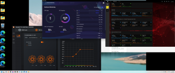

And Please explain a new curve for the GPU inside windows 11 software matched the current system speed of intake and exhaust. IS Fixed curve good for GPU software?
Fixed fan speeds aren't good for much. Also you don't need to match any other fan's speeds, the GPU fans are quite different from case fans. Basically you need to get away from the fixation of a certain RPM, and look more of the temperatures and the noise. Normally, if you bought a GPU with a good cooler, then you can leave its fan curve exactly as it is from factory. If the GPU fans are too annoying for you, or they switch on and off a lot under certain load, then you may have to set a custom fan curve for them. I would orient myself at the existing fan curve, just tweak it in some important places.
or the same question For AIO to reach a needed rpm of 1000 intake right now, which is pretty loud and i want to make it under 30-40 which the cpu is 46.88 c under idle
47°C would be very high for an Intel CPU in idle, maybe less unusual for an AMD CPU. So you see, i first need to know all your hardware in detail if you want me to help you in detail. Maybe also a photo of your system, so i can see where the fans and coolers are. Otherwise it's difficult to make specific recommendations. The only thing i can tell you already, 1000 RPM in idle, there is no need for that, it should start lower.
1. Setting the rpm in bios was listed as the only option if i turn on smart fan mode there i set up each dot manually -1. 28c at 29% rpm of 1200 for intake fan dot + 3 others up to 60c at 95% and on the other pwm fans i got the same reading in msi center running in bios rpm smart fan mode changes for system headers. however, you see it has a voltage adjustment for dc smart fan control, and from my bios i have 10mv adjusting to add for that fan curve and ive messed with it many times but followed the guide in the photo of this thread i seem to get a solid match with the other pwm fans but i have to fix the problem with software in msi center meaning i wont reduce it cause i just want it to equal the other or adjust it to certain temperatures. reducing the software makes it low but it cant reduce by smart fan mode permanent cause i run it on cooling wizard secondary in the past. thats for #1 question
#4 Automatically the fan on gpu never lets the 50C mark above, ive made a couple and temperature in case gets better all the curves, just dont like the 50c mark and up cause the zero db kicks in with the build in software mode, so i tried to move its three dots always at 1100 rpms and up from the bottom dot to 71% max
#5 Im not sure i understand the AIO temperature and the Processor temperature cause they have them in the aio software and msi center is reading teh processor temperature as the aio Processor temperature reading, above 17 degrees more different though at idle 49.99 degrees with the aio going low rpm 500 or so, and intake running 1000, ill cahnge the idle in msi center ? or bios msi ?>
For your graphics card, just below 50°C is completely normal in idle for the GPU, there is no need to start the fans at this temperature. This is a powerful card, and GPUs can easily take a lot of heat, 50°C is nothing. Spinning the fans in idle just so your GPU (chip temperature) is at 35°C, like you do now, it's not necessary at all. The hotspot temperature on your screenshot, it's called hotspot for a reason. Don't look at this temperature thinking you need to cool it down. Gigabyte selected a certain point for the fans to come on, because below that point, the GPU is perfectly fine without airflow.
Well, you have a CPU temperature, and you have a coolant temperature (the liquid inside the AIO's loop). The CPU will be hotter than the coolant. If your fans are connected to the motherboard's headers, set their fan curve in the BIOS. The Corsair software, you can control what's connected to the Corsair. I think the pump has its own two fan cables, then you could control the radiator fans through the Corsair software if you wanted to. But in the BIOS should be good for those fans too.

I'd setup the smart fan control pins like most people by entering them in via bios - each would be 1 -4 pwm and #3 system mobo DC header, intake on case only, making same curve on CPU selection four point curve in bios. I dont understand point of doing a cpu fan curve with 2 exhaust fans setup on 4-pin fans going onto a 2x 4-pin to 1x 3-pin adapter cable on MOBO. they are not very high rpm and settings on SYSTEM SOFTWARE were better with fixed speeds to get medium idle cooling temps, running the intake higher of course made the system all cool, + GPU running min speed. Likely followed a guide on instruction putting the aio in and made curves recently on software however the pump was not recognized in the mobo software in windows, just CPU FAN and that works only. COrsair makes the software in tuning and i cant complain it works when i need to keep idle or medium game sessions.
Yes i see the fan control on gpu temperatures get around 14c more with it off to perform the gigabyte operation, having it zerodb is fine but it kicks on at 1100 that is fine automatically kick ing on and on during idle?
Yes the pump has its own two fan cables going into CPufanheader 1, i understand it as mentioned about the corsair making the fan software to tweak as needed. does it need to be on curve to operate those in bios and inside pc altogether?
Aha, so it is 2x 4-pin into 1x 3-pin. I would connect them both seperately, directly to the board, if you want to control them better in the BIOS.
Your board has six fan headers, all of them can use DC or PWM control:
Forget MSI Center, it's not useful for much. Use your Corsair software, that does seem to provide a good overview. MSI Center cannot see what the pump is doing because the pump probably gets only SATA power from the board, and then the AIO is connected via USB to the board, to communicate with the Corsair software. But MSI Center only looks at what's on the fan headers. It doesn't check for stuff that needs a USB connection.
If the GPU's fans come on and off a lot during idle, because the threshold for the fans to turn on is right around that idle temperature, then it's better to adjust the curve to prevent them turning on too soon. Slightly raise the temperature at which they come on. If it's only idle or watching videos or so, they should stay off, that's the goal. Only in gaming, they need to actively cool the GPU.
If you somehow prefer the fans to run all the time (although it doesn't really have an advantage), then use the lowest speed they are capable of, for up to 50°C or so (GPU temperature, not hotspot!). But like i said, GPUs, especially powerful ones like yours, they will be a bit warmer in idle, nothing to worry much about. But yes, if the fans do this on/off thing a lot in idle, you need the change the curve a bit, then the default curve isn't that well-adjusted.

Thanks, id probably work the idle as you discussed with it making noise every minute wierd the noise of one of the three turning on like in icue you see the temperature of one gets hot and the other two are hotter meaning its not pulling the same speed when its in zero db mode on Control center for gigabyte it said it pulls zero with the fan turning and making sure its connected to speed it reads, idle or hot is specifically in 40-50 c idle and 60-80 c hot?
I think ill copy the formula for the PWM connectors on the two fans which makes more sense now, ill try that out and let you know if the bios reacts with no software but ill open a program this time like hwinfomontor, I only did not get the pump_ header for its purpose but that helps out the diagram image! Setting the system to all the same hardware monitor spec temperature Dots is my next job as the pump header+CPU header, thank you.

So i had another reply as of curtosy to the motehrboard picture under this comment - the AIO i have won't give me a y -adapter splitter its standard on the aio that includes a built in cable to the center cooler and it hooks up the two pin connectors for control of fans, so i cant just plug the included three pin DC connector that is also on the aio module into one? undertsanding it works in icue and it doesnt in bios but the three is dc so should i connect that aio connector the only one supplied besides sata and usb directly in motherboard or no? I have been using the cpu_fan header and the picture wont work cause its three connectors that go in the motherboard to get the bios support. H115i pro model, the board did not get either fans plugging in to cpu-fan 1 and pump fan 1 connector pwm mode and the three pin disconnected.
40-50°C GPU temperature in idle is normal for your card. Just prevent the fans from spinning up periodically in idle, by setting a higher temperature for the fans to turn on. Or set a very low fan curve for such temperatures, if you rather have the fans running constantly.
For me, i want to see all fans individually, even if i set them to the same fan curve. This way, i can see in HWinfo what is going on at all times, all fans are shown.
For your AIO, the best you can do is to experiment where you connect the fans. Connect it in a different way and see which way you like best. One way will probably allow to you set all the fan curves in the BIOS, and the other way will require the Corsair software. This is specific to your AIO, so i can't really give good recommendations without sitting in front of that system and seeing how it all works together. I can only give advice how i would set up a fan curve. I hope you got enough information about that now to come up with a good configuration.

awesome help that solved the threshold on the curve altered change found idle out. some temps run on three fans are warm, very new to me, but i get the next curve after that too, one in the orange (max) would be full speed for temp above 90c unequally on the fan readings max?
