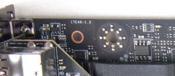

Some motherboard vendors show hardware revisions publicly. My last Gigabyte board, for example, would show on their website when they iterated the hardware so you could tell when something was physically changed on the board, it would say hardware version 1 or hardware version 2 or something like that. Do we know if MSI does something similar? I cant find anything to indicate when there has been a physical change or revision on MSI boards, but I might just not know where to look. I would want to know i will actually get something different before I try getting a new one again since I already tried with three different Godlike boards and all had the same problem. We can decode a manufacture date out of the serial number, so if they keep revisions private but someone gets a working board we can probably piece the clues together on when they made a change based on the manufacture dates. But I am hoping they are a little more transparent than that.
Can normally be found near the first PCIE Slot

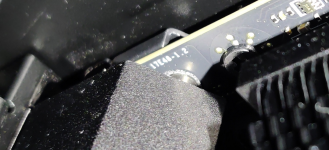

My board has a production date of March this year, I couldn't find the revision version by the PCIE slots but found something similar in the upper left corner:

P.S. This review from 2024 has a board (production date is unknown) with the same markings:
