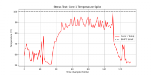

The Issue:I am experiencing sudden and massive temperature spikes. The CPU temperature jumps by approximately 50°C in just 5 seconds under load (or even moderate usage), which seems physically impossible for a functioning liquid loop unless the flow is severely restricted or the pump is dead.
What I have:I have recorded detailed thermal logs during these events.
  • I have CSV files containing the exact temperature behavior, pump RPM (as reported), and fan curves during the spikes. But forum does not let me upload them. I can email them to you if needed.
  • If there is an expert here who can interpret these logs to confirm a pump failure or clogging issue, I would be happy to share them.

I also suspect sediment buildup. When the pump runs at max RPM, I can hear a fizzing/gurgling sound, like water being forced through a tight space. Regarding the tubes; yes, I tested them and one is warmer than the other, but the difference isn't extreme (maybe 40°C vs 50°C), even when the CPU is at 100°C.
