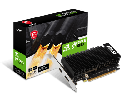

If not gaming then you are pretty much ok for any GFX card, I would recommend Nvidia as they have decent Linux driver support but we are currently living in a time of a massively overpriced GPU market so its not exactly cheap.
This one if you can find is probably the most sensible one to go for as its 4GB and HDMI / displayport, will do 4k 60Hz and is passively cooled so less noise / maintenance, will retail for around £70.
The cheapest nvidia card I can find is a GT 710 at around £40 but in my opinion it's not worth it considering how dated it is, if only it was a 5700G CPU in your bundle.

Thanks kindly for the link to an option in GPUs . . . . Historically I have had Nvidia graphics in just about all of my machines, as a former "visual person" I like the way Nvidia cards render the display in crispy manner . . . .
However, what I found on my '12 Mac Pro that I upgraded to a GTX 780 card to have "metal" capacity, I think it's a 3 or 4GB, is that in fact they don't really provide too much support for Linux drivers after a period of time. Similar to Apple, after a couple of years support is dropped.
These days I am mostly running linux distros, and I use "nouveau" rather than proprietary, but still I would have problems with getting the machine to resume from suspend, as the "G05" and "G06" updates (for example) would be taking over the drivers duties from nouveau, blacklisting it w/o asking me about it . . . and now the 780 is "ancient legacy" . . . and the newest kernels are not resuming at all.
So, this project was to move away from needing a GPU at all, and then, as needed to upgrade, switching out parts to stay closer to behind the technological wave than just letting the old '12 era parts try to make do. But, if a GPU is now needed, the inclination would be to go for Radeon?? perhaps being more compatible with the Ryzen cpu, or perhaps being less "high maintenance" than my 780 card has been???
I'll certainly take a look at your suggestion . . . my needs are largely humble . . . cheaper is "better" but then, junk is often very reasonable in price, or often just as unreasonable. Possibly if I were to go Nvidia I would just have to be more frequent about upgrading it, OR whenever I do this again, actually look to see whether the bundle provides graphics, or, quietly mentioned . . . does not.
When I looked at AMD offerings the prices were double as there is nothing other than high performance cards but this may differ at your end, what do you available / shop sites to look at? The Ryzen CPU won't have any implications on compatibility or support so you will be fine either choice.

I indeed did noot find any Radeon GPUs that I considered to be cheap, the problem with the 1030 IMHO is "no fan" . . . sometimes on rare days I run some distributed.net "stats" and that does use GPU capacity. My 780 card in my '12 Mac Pro does a fair job at it, nothing crazy, but adequate. I might guess that a heatsinked GPU would just provide basic duties . . . vs . . . bite the proverbiall bullet and get the right 5700G cpu . . . . <sigh>
