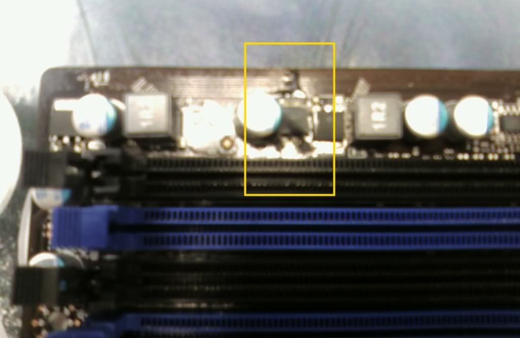

I have examined the mobo and found a discoloration / oily looking / burned section right behind the memory modules.  A small chip between another chip and the capacitor?(markings: 983 470 6.3v).
Was this caused by the mobo?  or the memory?

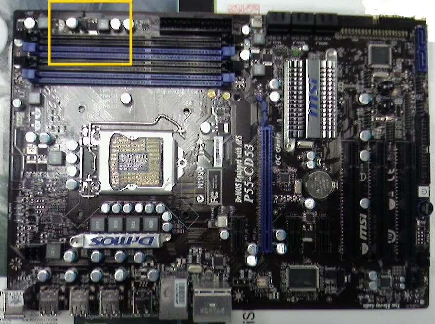

Here are photos of the board.  I put a yellow box around the burned out chip area behind the DIMMs.
Full pic of P55-CD53.  Location of burn in upper left area (see yellow box)
Zoom in to area

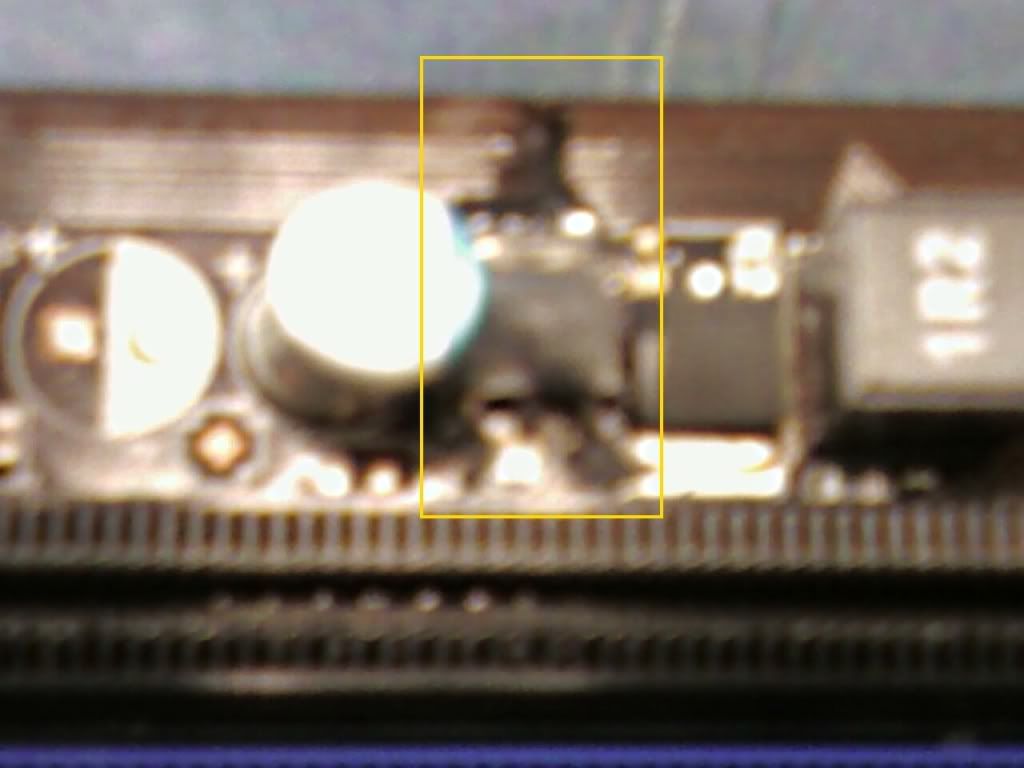

Close up of area (kind of blurry)

Aha, looks like a voltage regulator MOSFET got fried, probably for memory.
Did you have the PSU unplugged from AC power while changing parts around?
Yes the MB needs repaired or replaced.
