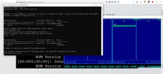

By searching a bit on the web, I came across this version 1.94 for our dear i225-V network cards. It is not an original firmware but modified it seems from the LM version.The link is here: Intel i225-V/LM NVM 1.94 FW personally tested it before proposing it. As you will see in the screenshot, there are no problems.
Updated this morning to 1.94, no more disconnect problems :D

This is information about my network card before flash the firmware. We will take information from the inventory.txt file to edit the nvmupdate.cfg file
I edited nvmupdate.cfg like this:
CURRENT FAMILY: 1.0.0
CONFIG VERSION: 1.20.0
; NIC device
BEGIN DEVICE
DEVICENAME: Foxpond1_I225_15F2_V_1MB_1p94_800003FC
VENDOR: 8086
DEVICE: 15F3
SUBVENDOR: 1462
SUBDEVICE: 7D91
NVM IMAGE: Foxpond1_I225_15F3_V_1MB_1p94.bin
EEPID: 800003FC
EEPROM MAP: Foxpond_Map_File_v01.txt
RESET TYPE: REBOOT
IMAGE DOWNGRADE: TRUE
END DEVICE
This is the complete contents of my nvmupdate.cfg file, I removed all other lines.
You should not copy other people's settings - you need to enter your own according to the sample.
I could not find the current version of the program EEUpdateW64e.exe. I would be grateful if someone shared it.
I don't remember whether I ran SecureFiles.bat or nvmupdatew64e.exe directly.
