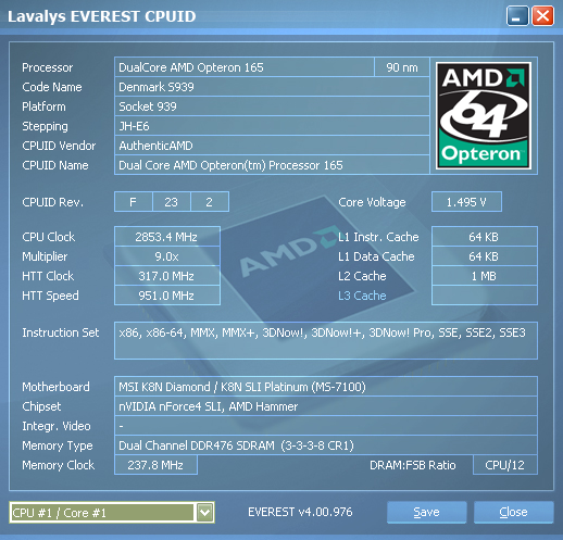

As no chance with ram or dividers I started fighting for some mhz extra and found some more (18mhz at least, resulting in 2853mhz total)  ;-((
