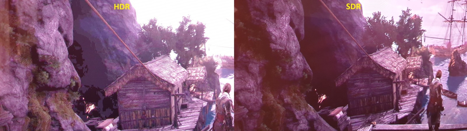

After the change in the HDR output occurred, I was questioning whether the Panel Protect process actually could have re-calibrated things and actually fixed an issue that was previously there. There's not an obvious issue in all cases, but after continued testing I still feel things are just not quite right - everything's just a little too bright.
Another reason I started second guessing if there was actually an issue is because HDR videos on youtube for example look fine, but I'm thinking that's because of the hard-coded tone mapping. So my suspicion is the monitor is no longer communicating correctly when it comes to more dynamic content, like the EDID/EOTF data or something on the monitor is not correct.
Here is an example of what's occurring (it's a bit exaggerated here due to using a phone to capture, but it gives an idea):

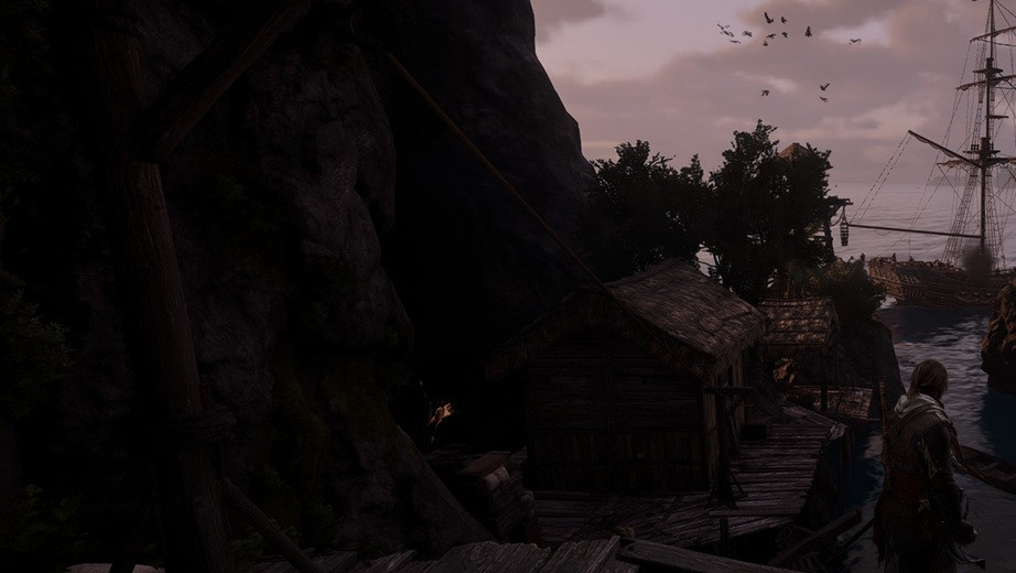

and here is the source image:
This image appeared completely fine in Windows before, and it also looks fine on my older HDR10 monitor, but the area between the rocks and other areas of the image now look overblown and low quality.
If anyone seeing this is also on a HDR display and see's issues with this image, please let me know :-). Thanks.
