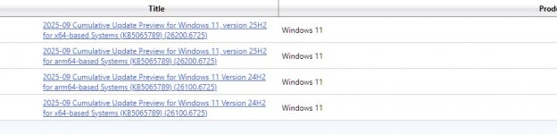

May be "KB5065789" not installed
update history in attachment, and which one i should install
