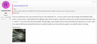

Hi all,
I have a similar problem, on my MEG X570 ACE I tried solutions provided by Alan J T, thanks to him for his help which I saw in all the other topics
The difference for me is that the RGB LED of the motherboard stays on in blue.
What I did:
- Unplugged all jraimbow, all USB
- Clear CMOS having disconnected the power supply and waited one night. I use this video for help.
- Try MSI's LED software but "device not conected", no update in MSI center.
- Install Windows 10 and then Windows 11 again.
- When I turn off the LED control in the BIOS, the LED stays on on the motherboard. I use the last BIOS (1.0o 03/29/2024)
- The last thing I didn't dare to do was the jumper on pin #4 and #5 with the PC on as I read in another post, that scares me a little.
- Now, when I try to launch Mystic Light no longer launches...
I'm at the end of the ideas I can try, if you have a manipulation, even physical on the motherboard.
Thank you very much
Mondi

Looks like it is faulty please return for exchange under warranty or RMA
