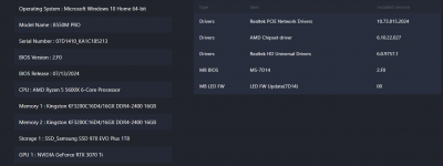

Mainboard led firmware abnormal. Update MB LED FW
Nov 29, 2021
Has anyone else been running into this issue with the MSI boards? I been through 2 boards already and it has been giving me this same issue. I'm ready to throw the dam thing out the window. Apparently I'm not the only one either from what I looked up on Google. Has anyone found a work around for this yet? Or do I have to return the board or get it fixed? It seems this happens every time I tried to daisy chain my cases M/B D-RGB 3 pin daisy chain male header into my MSI MAG 240r female header that is daisy chained and connected to jrainbow 2 port. I'm suspecting that I'm screwing up the LED firmware on the boards by doing this as the msi AIO fan rgb, mobo rgb were lighting up. When I connected them, the case rgb lit up but the AIO and mobo weren't anymore. Shut it off and turned it on and now nothing lights up besides the rgb ram sticks. Tried clear cmos, turn off and on rgb on mobo, unplugging and turning off and on power cord, and making sure the connections are all right. I'm also new to argb and daisy chaining so I would appreciate any input anyone has. I will be getting the phanteks rgb fan hub for the case lights and see if that makes them go on. Updated bios and everything i could think of under the sun. Also will a rgb fan hub be able to turn on all the rgb if its not connected to the mobo anymore? Checked all connections and they seem to be right but took photos so anyone can tell me if I missed something. B550 tomahawk, MSI MAG 240r AIO, AMD Ryzen 3700x, Kingston 3200 2 sticks of ram, Thermaltake 700w psu, case phanteks p360a.
I was also just told by Phanteks that my drgb controller may be defective as well. So Im probably bricking the LED FW on the Mobo by connecting the M/B DRGB cable into the female header of the MSI AIO 240 mag that is connected to the Mobo. Is this Mobo salvageable? Or did I just screw this up again and need to return the board or RMA it?
Mystic Light mainly, but I have tried them all. Nothing can recognize the fans reliably. I've been talking to MSI tech support and we have come to the conclusion that the board is defective and it's going back. Thanks for your help.
