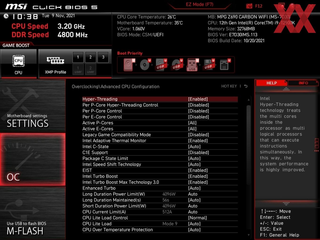

Possible, but just set it under OC - "Advanced CPU Configuration" in the BIOS. Short and Long Power Limit, both to 200W. You first may have to press F7 for advanced view in the BIOS.
Example of the power limits maxed out (4096W each, result of selecting "Water Cooler" option):
So there you'd enter 200W for both limits, and you can also set C1E Support to Enabled, then press F10 to save and exit.
