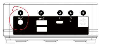

Yes, it is.
You've connected the MIC in combo jack here right?
Yes. Actually its from the phono output from the amplifier, I'm trying to find a microphone with a 3.5 jack. The usb-a port on the front works with my microphone.
