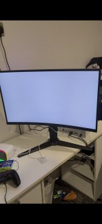

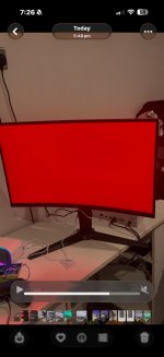

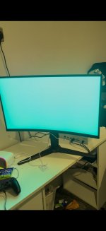

I’ve been using an MPG 275CQRXF 27” monitor for almost a month, and it’s been working perfectly — but recently, after turning it off and back on, it started cycling full-screen colours (red → blue → white → black) and won’t display any input from my devices.

What happens:
  • When unplugged: powers on briefly, flashes white, LED turns white, then turns off after ~5 seconds.
  • When connected to a console: immediately starts cycling colours again, and the menu/OSD does not appear.
I’ve attached pictures of the flashing screen.
