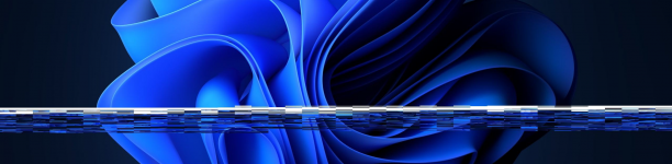

- I've two monitors connected to the 5080. With the Carbon, the OLED always flickered very slightly in dark areas at first few minutes (gaming was always fine). With the Dark Hero, I don’t see any flickering.

5080 flickering has nothing to do with motherboard
It definitely does. Other users (HWL forum) and I can prove it. It's no surprise when the recovery count goes crazy (as described here) and the GPU can't work properly. Just a comparison of two different systems, both running X870(E) MSI Boards with RTX 5000 and 9000X3D CPU:
Display issues related to the cold boot-/PCIe-bug with X870 Tomahawk + 5070Ti (all hardware brand new, only Expo, rest stock):
Display issues with my Carbon Wifi and new 5080:
Very similar error pattern. After a restart, everything always worked perfectly. This is definitely a motherboard issue related to the PCIe initialization of the hardware and not a GPU issue. If it were a GPU issue, there would also be problems after a reboot and/or under heavy load. However, these issues occurred ONLY from a cold boot.
If you said the onboard VGA on the the HERO has no flickering while the onboard on the Carbon has, I would say it may be possible due to HDMI components and circuits embedded on the motherboard. It is also possible to be is more on the OLED monitor side then VGA or Motherboard.
I really hoped that the MSI motherboard wasn't the cause of the problems. I tried different DP cables, I tried different HDMI cables, I tried using just one monitor (and a new one), I tested different refresh rates on both monitors, I tried several old and new BIOS versions, hundreds of BIOS settings, and so on and so forth. Absolutely nothing helped in the end.
The user on the HWL forum was smart. He saved a lot of time and just got a different (Asus) motherboard. With exactly the same hardware and exactly the same settings (only Expo, everything else stock), he had no GPU issues, display artifacts, etc. For a long time, I hoped that MSI would fix the problem, but it seems they’ll never do it, or maybe they just can’t (hardware related). Just a “small” selection, all of which have the same cause:
