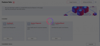

Hi!
This is my first post so apologies if info is missing.
I just installed my MSI mpg coreliquid p13 360 AIO cooler.
1st boot after installation showed the LCD turning on, but now doesnt do anything.
I wanted to check the MSI Center to see if there are updates that need to be performed, but the application is soooo slow.
When I click "open" on the Coreliquid application, it just keeps loading and loading.
Re-opening the application, re-installing the Coreliquid app and restarting my PC doesnt help.
Any help would be appreciated as I have no clue whether the AIO is actually doing something

I was finally able to scan for new updates, but none are found.
My AIO cooler is not listed in the MSI Center while everything is connected properly.
Based on the fact that on the 1st boot the screen lit up and the water started running I presume verything should work right?
Screen even lights up again showig the logo if I turn off my PC, draw all remaining power from it and then restart the PC
Any ideas?

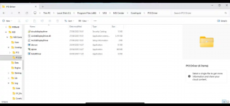

Hey there!
Well i solved the yellow warning (i had warning code 28: no driver installed) recently, but im not quite sure how I did it…
I was testing a bunch of stuff…
Last things i did was a fresh install of MSI Center (not via Windows store but via MSI website) after a complete uninstall via the official tool (can be found on the P13 360 support page where you can download the MSI Center version).
I also unplugged and reconnected the USB connector of the cooler while my PC was running so I confirmed in Device Manager that it was correctly recognized by Windows.
I looked in the folders of MSI and suddenly found a folder namer “P13 Driver” (was not there ever before!). I attached a screenshot with the full path to this folder so you might find it more easily.
I ran the application “dpinst” and “installDriver” and my LCD turned on afterwards!
The infinite loading is still under investigation but i hope this already helps you with your display! :)
Let me know if it worked out!

Hey, thank you so much for your help and for taking the time to explain everything 👍
I followed your instructions step by step, but unfortunately I still wasn’t able to successfully install the driver for the watercooling on my side.
I wanted to ask you: would it be possible for you, by any chance, to share your “P13 Driver” folder with me? I’d like to try to manually force the driver installation and see if that fixes the issue on my system.
Thanks again for your help, I really appreciate it.
Let me know if that’s possible 🙏
