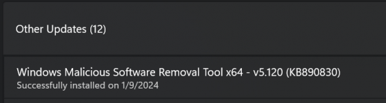

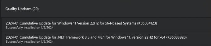

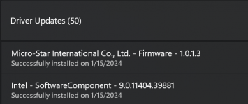

Hi thank you for the reply,
Here's a log of the latest updates I've done through Windows Update (attached below)
the rest are just some Definition updates.
Aside from that, I did the latest Nvidia (546.65) driver update, and rolled it back a few hours ago back to 546.33 which worked fine before the issue started, but now isn't so it's probably not that but I'm not sure.
But of course I also did the big boy, 23H2 (I'm on Windows 11)

My CPU temps are skyrocketing even on idle. It's jumping to 90C + and drops to 50~ and goes constantly. Before the updates, on idle I would be at around 31-37C all times.
Try to uninstall the firmware update.
I think I found the issue,
Seems that a certain extension I added to Chrome (for translations and text-to-speech) from the Extensions store was causing a significant amount of CPU usage leak, and was getting worse. As soon as I removed that extension, my temps calmed down again, lol.
I hope that was it, because I really don't wanna undo the firmwares!
