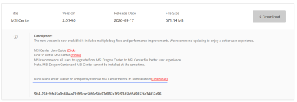

I just checked it, my MSI Center is up-to-date, there are no updates available to it right now, and its version is only 2.0.71.0, which update happened a couple of days ago.
How is it possible that you have newer version?
Which MSI product being used? On MSI mainboard's website utility download page, there's MSI Center ver. 2.0.74.0 available. Make sure to use Clean Center Master to uninstall the older version then to install the latest MSI Center.
