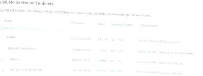

sorry for the quality of the images :( the white one is my secondary desktop and goes at 190mb download speed, mine the MSI infinite is the one with black screen and goes at around 50mb both of them goes at 48 upload speed. i've changed the router to day with a FritzBox 5530, i dont know with setting of the router you need, maybe the one i've attacked?
All looks great at black connection screenshot.

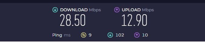

and check what speed you will get in there and post screenshot (of whole screen, not just the speed)
this is what i got, the other PC is almost the same but he reach almost 190 Dspeed
then you probably have some software installed (with traffic shaper abilities) on that PC that limits your internet speed.
from the operator ive declared 150 download speed with fiber and Glassfaser (i dont know how to translate that)oh what it can be? i've only installed the basic MSI softwares from the day one and a pair of games nothing more, maybe is something from MSI center?
