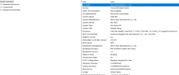

That is quite odd. Could you take a photo of the main BIOS screen, as well as a screenshot of the HWinfo "Summary" screen? I want to see what is read out by the BIOS vs. by the OS.
Y'know.. this had occurred to me as well (and I should've posted that info on the original post) but insofar as from what I've read, Windows can sometimes retain 'misinformation' and/or mis-identification from an earlier period (IE: prior to the latest BIOS update). But this is what it now says, so I am well and truly mystified as to what exactly is happening here (although in doing this I also noted that the BIOS date seemed that it might NOT be 'current' since the latest update was released on 04/09/26) so just to be certain, I downloaded and flashed once again and now see (as I did before) it reveals a BIOS date of 03/04/26 (.. Hmmm...)
BUT - still it identifies the processor as the i7-13700 processor as shown in the attached pic I took just 5 minutes ago. So... Not certrain what to think. And I also noted that the Intel ME firmware was included on that support page, so ALSO did the ME firmware update separately as well - but this too had already been updated via the BIOS flash and I wouldn't think the Management Engine firmware would have any affect on a potential 'microcode misidentification'. But what the heck do I know. I dunno... a mystery for me I guess...

And my bad... I forgot to include the msinfo screen on the earlier reply, but when I get back there I'll do a screen grab and send it along... but this too seems to reflect an i7-13700 if memory serves. But hail.... by now I'm questioning everything, so... get back to ya here ASAP

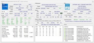

I'd forgotten I even had the HWINFO app - but (since it was 'older' version) also re-downloaded the latest version and just ran it and this is what I got.. (see pic)
So -anyone want to lend their best opinion as to just WTH is going on here? If it weren't for the fact that this hardware is buried inside the PC that I'm using right now, I'd take a quick pic of the top of the processor and send it too, but from what I can glean from the info I can see in this shot, I am thinking some sort of 'mislabeling' thing (??) or - elephino... 'cuz I don't. Kinda beginning to think this is an actual, honest-to-god i7-13700...! As to how THAT happened, well..no clue here... 'cuz I paid Amazon only about 1/3 that 'normal' price for an i7 (IE: like close to $430..?). Sheez... Things like that just don't happen to people like me...

Well. It certainly looks like a real 13700 here. Eight P-cores (with 16 threads) plus eight E-cores, while the 13100 would just have four P-cores / eight threads and no E-cores. Base clock and maximum turbo also matches the 13700. In fact, it all matches, down to the Spec Code SRMBA.
Do me a favour, let's look at a few things at once next: Start HWinfo Sensors, and produce full CPU load with Cinebench R23, running the "CPU Multi" benchmark. After completing a 10 minute run, note down the score and take a screenshot of the full-screen HWinfo sensor window, with all the sensors visible at once, like this:
The resulting score and the sensor data will tell us without a shadow of a doubt what CPU this is. Well, the CPU might not be able to stretch its legs that much, I wouldn't think that you'd use a huge air cooler or a water cooler for it. But we should get enough clues.
As for the 13100 vs. 13700 thing, a 1 and a 7 are easily confused, especially depending on where someone is from. For example in the US they can write "I" for 1, which in Europe would never happen, we also have a horizontal dash going through the middle of a 7. But that 7 without the dash in the middle can look like a 1 to someone, depending on the font they may use in whatever software they're looking at. Of all the different CPU model names, those two are for sure the most similar-looking, so I could see how this can happen.

Alright. But by all indications, that's a proper 13700. It would be next to impossible for all readouts to match it perfectly, so this is not a wrong model name read out by the BIOS somehow. Because then most of the other things (especially the multipliers) should match a 13100, but they match a 13700.
