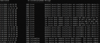

I'm having the same problem as the original poster. Is this method the workaround for applying the secure boot certificates without Secure Boot enabled? And does this need to be done for more than jus twindows UEFI CA 2023, but all of what seem to be additional failed certificates (in my image attached)? It seems that without Secure Boot enabled, I cannot get the certificates to install via the expected Windows Update process.
After a BIOS update on a Crosshair 15 A11UEK (which I'm kicking myself severely for) I am unable to boot to windows without disabling Secure Boot.
I am getting event error 1801 (Certificates available but not applied to firmware) and error 1796 (Failed to update KEK 2023, Windows UEFI CA 2023, etc). I've attached event errors I'm seeing.
One thing that I find interesting is that I did receive a positive event code 1808 (Device has updated Secure Boot CA/keys) at 9:33pm on April 10th. This was in the midst of my troubleshooting to boot into Windows without having to disable Secure Boot. Since then I've only received the errors and cannot find a way to force these to apply.
I'm also no longer getting these event errors since 1:49pm today, despite numerous reboots in attempting to fix this. I'm a little concerned by that.
Any insight or suggestions at all would be hugely appreciated.
Also, worst case scenario, would a full system factory reset resolve this despite my BIOS update, which seemed to trigger this?
