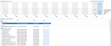

Do you mind showing us your "view reliability history" like this?
Like now days, Windows update and drivers are buggy as hell because of Vibecoding/ AI Hype and windows 11 tends to auto updating without warning. The crashing may happening because just so happen due to a fault driver is being automatically updated by Windows Update. It is no longer plug and play in current age of laptop computer. You may required to know more about "How does the computer work? Why is it crashing?". There is no full solution to fix "why computer crash". Every "crash" is different and unique. If you want to receive helps, its best to ask ai "how to provide windows crash information so that people can help?"

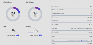

hi there. same issue. i did clean my windows at all 'format' and i used msi center for update my drivers. even i try other way manuel. but didn't work. cpu always work +95C i have laptop stand also .and also doesn't help as well. as i say this computer secound one. first one also same issue and cheek forum. a lot of people have same problem.
This is my Reliability test hope with this u can let me know what I need to do next
