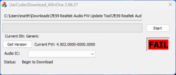

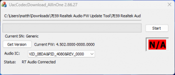

I attempted the firmware update using the provided tool.
  • The utility detected the codec (RT Audio Connected).
  • The update failed immediately after "Begin to Download."
  • Afterward, Device Manager showed Unknown USB Device (Device Descriptor Request Failed).
  • I uninstalled the Unknown USB Device, and Realtek USB2.0 Audio disappeared at the same time, suggesting they may be related.
Has anyone seen this behavior before? Is there a recovery procedure for the ALC4080 firmware, or is this indicative of a hardware issue?

If running the audio FW update tool still cannot restore the functionality, it is possible that the Realtek audio chip is faulty.
I have attached the log from the firware updater tool. i can see now why it failed.
USB\VID_0BDA&PID_4080&MI_00
CFlashInfo::FFU_Download:> START --->>>
CMpFlow_Flash::FF_UpdateEx_Standard:> START --->>>
----------------: Disable Write Protect Fail
CMpFlow_Flash::FF_UpdateEx_Standard:> EXIT <<<---
I also tried using this in a windows pe environment and it still wouldnt work, turned off hyper-v and hyper-v platform, turned off core isolation.
