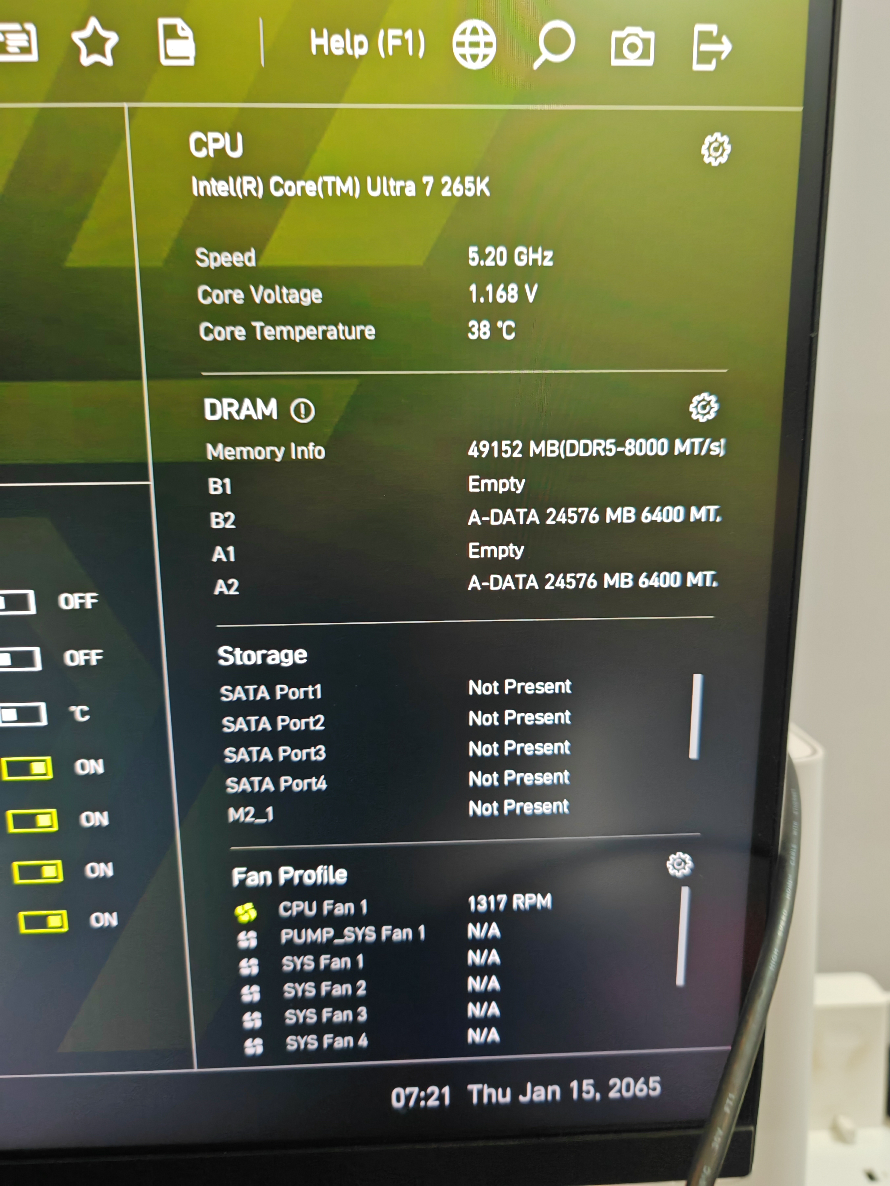

I want to provide an important update regarding my previous troubleshooting. I have just tested the system with a Corsair DDR5 kit, and it booted instantly without any issues.
The motherboard recognized the Corsair modules immediately at 4800 MT/s.
The Error Code 55 only appears when the Patriot Viper modules are installed, even after trying manual voltages of 1.300V and Slow Training.
  • This confirms that the CPU (Ultra 7 265K) and the Motherboard (Z890 Tomahawk) are functioning correctly.
  • The issue is a definitive compatibility conflict between the current BIOS version (1AA0) and the Patriot memory kit.
