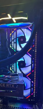

I have found the solution. I was switching off all fan groups from hub one by one - back EZ120 didn't produce noise; 3 EZ120 on radiator of E360 Liquid Cooling didn't produce too - the noise came from the side coolers working on blowing air into the case. Look at two screenshots - on the Youtube screenshot from building the similar PC, he placed EZ120 tripple fan on the side behind vertical montage guides which blocked visually 15-20% of each fan square, while fans are working, these metalic parts are separating the air flow into central and periphery and it was giving loud noise. I just placed tripple fan above these metal parts and now - no noise at all! Complete silence - when it starts, when I am launching rendering in 3ds Max and Corona render/ VRay. So for sure - the reason was in construction of the exact case. For "perfect" look as I understood are needed EZ120R (reverse) fans but i don't need it too much, I love how it looks and works. Anyway, thank you for attention to my case.
