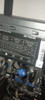

Can you look up the exact model of the PSU, or take a photo of the PSU with the sticker visible? "400W Game in game" sounds like a no-name, very low-quality PSU, to be honest. What can sometimes happen with a PSU that's too overly bad and/or old, the flashing process can appear to succeed, but the BIOS got corrupted during flashing, then the board cannot boot afterwards.

The fans do turn on, also the ram is mismatched kits with 1 4gb and one 2gb stick running at 1066 Mhz, It did say "Bios updated successfully" then it started turning on and off and compeletely off after a minute with no display when i turned it back on. I tried booting with just one ram stick too btw it still gave the same issue, atp im just better off replacing the motherboard i think
That PSU is electronics garbage, I'm afraid. It's a group-regulated no-name PSU of the lowest quality, you can immediately see that from the specs, it's really a 300W PSU, and that's pushing it. Not that your system actually draws close to 300W at any point, but the thing is, such PSUs tend to have very bad output quality of the voltages (high ripple, bad regulation), which could even throw off the BIOS flashing process sometimes. And, as you have experienced, such no-name PSUs cut corners everywhere they can, so they are often missing vital protection circuits. With any slight issue like a power surge, they either die immediately, or they even take other components to the grave with it.
So the first thing that has to be done here, that PSU has to go. I probably wouldn't even sell it, I'd feel too bad to sell this bad of a PSU to someone. This is a PSU you give to your enemy, not sell to a random person. So I would probably just take the loss and give it to electronics recycling. You need a brand-name PSU that's decent and at least 80PLUS Bronze rated, see my PSU guide. This is the bare minimum for a PSU nowadays.
But that's only to prevent things like this from happening again, it won't suddenly make everything work again. Because right now, if I had to guess, with a PSU like this, something went wrong during flashing, and the BIOS ended up being corrupt. The board cannot boot with a corrupt BIOS anymore. So now, the BIOS would have to be flashed properly again. Since there are no onboard means of doing that with this board model, the BIOS would have to be flashed using an external flash programmer like a CH341A, this kind of method (bit more info here). So you either need to buy such a programmer (they're cheap) and research how to flash the BIOS with it, or you ask a local PC/repair store if they are able to do this for you.
