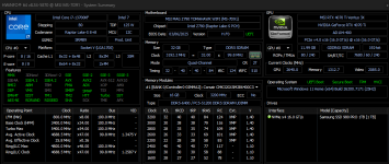

this is my system in order to get more fps in cs2 i want to overclock one of them can you guide me citay?

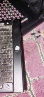

ok so idk wtf js happen i was trying to fill it and then the plastic thing was stuck when i was pulling it real slowly it doesn't drip that hard but yeah it still drips a little bit slowly any idea what to do am i screwed?

So the tip of the bottle has broken off inside the filling port, or what has happened here? Well, then you need to remove the plastic bits, and the filling port needs to be closed properly again with the screw. No dripping of any kind, otherwise you have a problem, not only can the coolant escape, but also drip onto your hardware.
