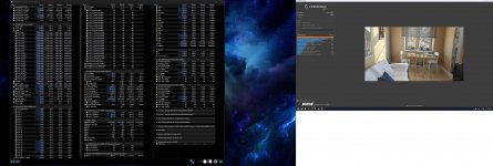

Ive tinkered with these settings on my own, and these are my findings:
For information, this is my build:
MSI MAG Z790 Tomahawk Wifi MAX
i9 14900k
Deepcool LT720
G-Skill Trident Z5 DDR5 6400
RTX4080 Super
My Cinebench 24 score was about 2100, with the TDP reaching nearly 400 watts and my CPU absolutely cooking itself. I lowered the PL1 and PL2 to 253-300 and reached about the same score.
With the new MSI BIOS update, the scores plummeted. It was due to AI-CEP being enabled with a Load Lite of 10. Increasing that to 16 made it stable, but again cooking my CPU.
I decreased the voltages with -0,110, dropped the Load Lite to a stable 12, PL1-PL2 at 200-253 and 310 Amps.
I have yet to test the AC/DC settings. Intel Default Load Lite got me a bit too toasty
My current Cinebench 24 score is 1951, so its about 10% slower with the intel recommended settings, but the temperatures average around 66 degrees, with peaks to 85. For some reason, the Cinebench R23 ran for 10 minutes straight, without throttling, and when I took a screenshot, it started to throttle at 85 degrees.
Intel recommended me to RMA the processor due to thermal throttling.
I will wait until after the microcode patch before I do that, because this just seems to be that weird voltage spike it has during low effort tasks.
i9 14900k
Deepcool LT720
RTX4080 Super
I know I’m probably driving everybody up the wall with all my posts of late, but I didn’t want to ignore your post. Thank you for sharing your results; they’re exactly what I would suspect. See my note above. There are definitely combinations of user settings and BIOS versions that work best, and I just think one has to be careful not to mix and match them accidentally. I think you can take different paths to reach the same destination, which is my whole undervolting table thingy, but the trick is obviously picking one method at a time based upon your comfort zone/experience.
It looks to me like MSI / Intel are trying to automate the process so the Raptor Lake user has a more plug-and-play experience - while trying to solve the instability issues, of course. However, in my humble opinion, the latest BIOS releases neither help the novice nor the super-user. And they especially don’t help the guy in the middle who likes to tinker. My best advice (given all the empirical evidence I have crunched to-date) is to either stay on (or rollback to) a pre-Intel advisory BIOS and use the traditional method of undervolting, combined with a manual multicore overclock (to eliminate single core boosting), or just wait for the latest Intel BIOS and experiment like crazy, i.e. with and without using CEP, and CPU Lite Load=Intel Defaults, etc. In theory, I guess there could be a benefit to the new eTVB bug fix and the upcoming voltage bug fixes. But again, how hard are you going to have to fight against these new auto-mechanisms that drive down performance or drive up TDP? Hey, perhaps I’ll be proven wrong and the new August code will finally deliver acceptable results out of the box. We’d all be happy campers then!
Keep us posted with any of your further tinkering results.
