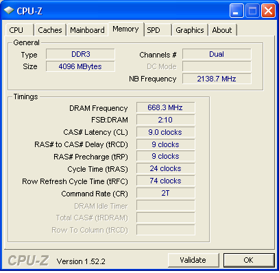

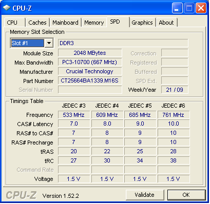

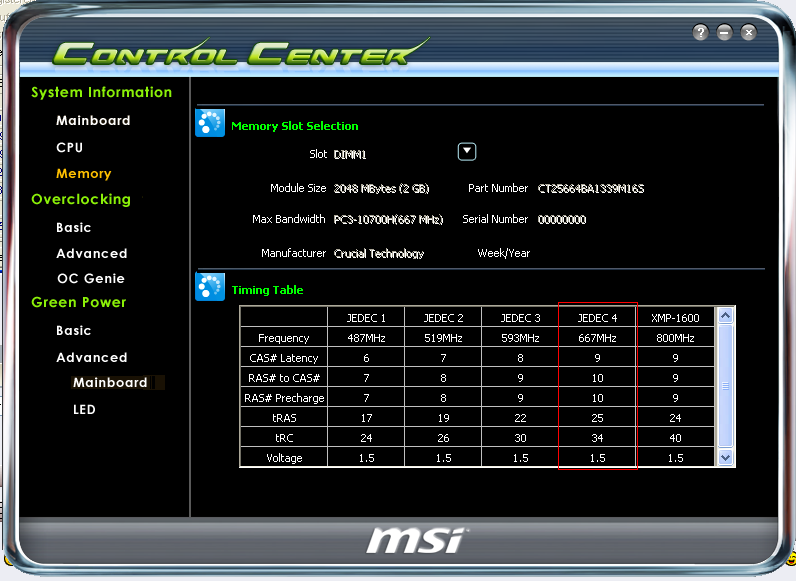

Hi all, and thank for all the good suggestions in this thread
Status:
I'm now running my Crucial RAM at 1.672V, CR = 1T,  which seamed to make the system much more stable.
Although I still get some corrupt file or Check Sum Error time to time. Even after downloads from big reliable sites like cnet.com or nzone.com
Q:
What I still no not understand is why the timing tables does not match with the ones in CPU-Z, see current settings:
and "suggested"?? timing tables
and
They just no not match, or are I just not understanding the settings!?
Attempts:
I tried to set the settings as shown in ControlCenter for 667Mhz in BIOS, but with that change the computer did not start and resetted it self with the latest working BIOS setting.
Also I could not find any timing tables on Crusial web page! Strange!?
