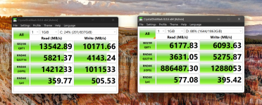

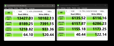

Wait a minute, while I have not had the link speed issue since vA41 either (now on vA52), but my RND4K Q32T16 scores seemed extremely poor. I was looking for something to compare with, and found yours in this very thread. My first drive (C) is a T705 gen5 1TB with integrated heatsink, and my second drive (D) is a Silicon Image XS70 4TB gen4. I looked at my old benchmarks from an older bios (Feb 2025), and both drives show normal Q32T16 performance like how it needs to be. The issue is with both drives, not just one, so it's not even drive specific.
Any ideas why guys?
Now on vA52:
Feb 2025 (didn't record which bios I was on), but same exact HW. See how much higher the Q32T16 perf is
