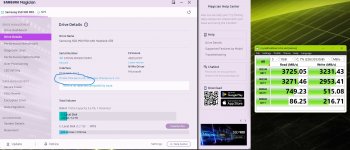

So i swap from M2_1 to M2_2 but even this dont solve it! I got half the normal speeds 3500Mb/s instead the normal 7500MB/s! i got without the RTX 5090 in the PCI-E slot installed!

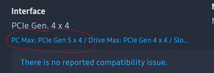

How come Samsung Magician shows this? Gen 5 x16 is only for GPUs? Mine shows PC Max: Gen 5 x4 in this section

GPU's have access to 16 lanes. Nvme drives to 4 lanes. What you see is correct. Problem is the M.2_1 is randomly going from 1 x4 to 5 x4 and not staying at at maximum rated speed by either Auto or manual BIOS settings.
I know that, I was just wondering why Samsung Magician on my pc shows the PC Max as gen 5 x4.
My GPU works correctly and at x16
Not sure why Samsung SSD software would even care what link speed the GPU is!

It's saying your MB supports Gen 5 x 4, and your 990 Pro is 4 x 4. It says nothing about your GPU.

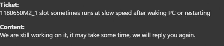

Their latest reply after I asked for an update on the ticket yesterday
It does sound like they've acknowledged the problem, at least on some boards.
