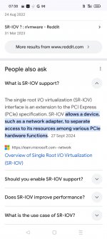

Certainly, looks good. But you can try to disable ASPM and enable SR-IOV support. You should know that Network adaptor attached to PCIE lane... ASPM L0 means that system set a low power consumptions to PCIE lanes. If all that still doesn't works, either your CPU socket got some pin bends or the connection between wifi module and motherboard itself broken...
Well, I disabled ASPM, enabled SR-IOV, cleared the CMOS multiple times and did a fresh Windows 11 install. Scanned and installed all drivers, and the WLAN still doesn't appear in the Device Manager. I guess it's time to go the RMA route and hope the next one works.
