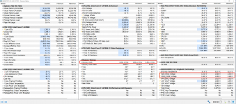

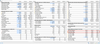

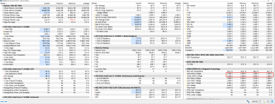

Here's an example of an AMD system (X570 with Ryzen 3900X). The tool HWinfo64 can show those frequencies in the "Sensors" window.
DDR4-3866 is too much to run in 1:1 mode, so the divider for the memory controller is active and performance is worse.
DDR4-3600 manages to run in 1:1 mode and the performance is better.
The best thing on both platforms nowadays is to run DDR4-3600 without a divider and with some nice low timings if possible. Something like DDR4-4000 will usually make the BIOS enable the divider for the memory controller and it will be slower overall than DDR4-3600, despite the higher RAM frequency. This is because the latencies are effectively increased when the memory controller has to work at a lower frequency. With a DDR4-4000 kit of RAM for example, i would enable XMP, but then manually set a DRAM frequency of DDR4-3600. This should make the BIOS remove the divider for the memory controller and the performance will immediately be better.
