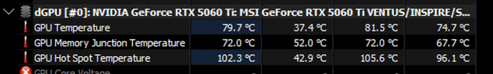

When the temperature on my "MSI 5060 TI 16G SHADOW 2X OC PLUS" crests over 80C--still below the thermal limit from what I've searched online--both fans hit 4000+ RPM.
A horrendous noise that I could avoid entirely if it didn't trigger at 80C, assuming HWINFO is correct.
The ridiculous part is that when this happens again, when it crests over 80C some seconds later (but stays below 83 C), it does not shriek like a banshee the second time around. So what gives?
This makes the card almost unusable when I want to use it for a heavy workload. I'm chalking this up to poor driver behavior and hopefully not that the heat sink is this inadequate. The card is undervolted, it doesn't even pull 160W under full load.

This MSI 5060 TI card reaches 25+ degree Celsius hot spot over the 'GPU Temperature'.
And given that Nvidia hasn't actually officially stated what the max throttling temperature for desktop Blackwell GPUs is, this is what I have to go on.

Yep, the hotspot does seem to be a tad too warm
1. Your problem is indeed clearly related to the failure of the thermal paste. This is similar cases. (You should have seen.)
Unlike your ASUS Prime card, the heat sink on this cheap 5060 TI model I have basically has no thermal headroom, which makes the thermal interface load-bearing for this card.
Any sign of thermal paste drying/pump-out will eventually result in throttling temperature.
I might just have to buy a phase-change thermal pad.

I attached a HW INFO screenshot with the card pulling nearly 180 W. ~2700 RPM fan speed. The PC case is open mesh with no fans underneath the GPU but free space; room temp. is ~27 C.
