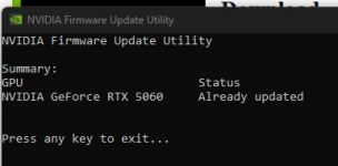

Yes, I already tried the NVIDIA GPU UEFI Firmware Update Tool for the RTX 5060.
Unfortunately, it reports:
NVIDIA GeForce RTX 5060 — Already updated
GPU-Z also shows UEFI Supported: Yes, but the MSI BIOS still reports "There is no GOP support detected in this card" when I disable CSM.
So the issue remains even though NVIDIA's official tool says the firmware is already updated. Any idea what else could be causing this?
