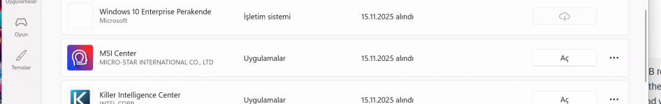

I'm very sorry, it's not working. In the MSI recovery window, I select USB recovery, it recognizes the USB and I select it, the "Next" button becomes active, but unfortunately, when I click "Next," it doesn't respond. Also, it gives an error saying "burn recovery function not found" while creating the ISO.
I'm wondering where I went wrong, or is it because the program belongs to "MSI Dragon Center" and it doesn't work on my computer? Could you please check and suggest a solution?

After a few attempts, I finally succeeded:
1- I reinstalled the computer, installed MSI 2.0.63, but experienced the same problem.
2- I found and downloaded MSI Center version 2.0.35. This time, the backup-recovery section worked, and I was able to create a system backup to a USB drive.
Thank you very much for your efforts.
