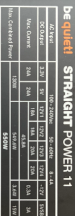

Board: MSI B450 Gaming Pro Carbon AC
BIOS: 7B85v1H7(Beta version) or 7B85v1H4(Beta version). I think I have the H7 but I’m not 100% sure.
VGA: MSI RTX 2070 Armor
PSU: be quiet straight power 11 (E11-550W)
CPU: AMD Ryzen 5 2600
MEM: 2x8GB, 3200 MHz G.Skill Ripjaws DDR4
HDD/SSD: 1x Samsung Evo 870 1TB, Crucial MX500 2.5” 500GB
COOLER: be quiet Dark Rock 4
Keyboard: Razer Blackwidow TE Chroma V2
Mouse: Razer Viper 8Khz, USB
OC: ?
OS: Windows 11 64bit Professional (Samsung) and LMDE 7 (Crucial)
