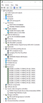

I have a GE72 2QF APACHE PRO with a 128 GB SSD for C drive which is the "System" drive where windows 10 is installed, and a 1 TB HDD which is used for data.
The 128 GB is now almost full and needs to be upgraded to a higher capacity drive. Looking at this post: [Which SSD I need for my GE72 2QF APACHE PRO laptop?] regarding installing a M.2 NVMe PCIe SSD by changing the BIOS Boot Mode to "Legacy", it is tempting to do the sane. The question: what is the downside to switching the BIOS Boot Mode from UEFI to Legacy ? The device manager pic and specs pdf are attached.
Thank you in advance.

The main disadvantages of changing the BIOS boot mode from UEFI to Legacy are:
Lower security features UEFI prevents malware execution at boot time through the Secure Boot feature. Switching to Legacy mode disables this feature, reducing security.
Lower boot speed UEFI performs hardware initialization more efficiently, resulting in faster boot times. Legacy mode is relatively slow.
Limited support for high-capacity storage devices Legacy mode uses the MBR partitioning scheme and recognizes only up to 2TB. On the other hand, UEFI uses GPT and supports more than 2TB. If you are considering a larger SSD in the future, UEFI is an advantage.
Possible need to reinstall Windows Windows that is already installed in UEFI mode may not boot in Legacy mode. In this case, you may need to reinstall Windows.
Lower compatibility with newer hardware NVMe SSDs are generally optimized to work in UEFI mode. In Legacy mode, they may not be recognized or their performance may be limited.
