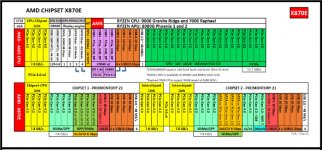

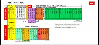

If you’ve been building computers since the ’90s, it’s really surprising that you don’t want to understand the different markings for the various motherboard versions... It's always been that way.
And with the X870 in particular, the differences are really significant. The one marked with an “E” has an additional chipset, which provides expanded capabilities in the form of extra ports, for example...
See the images:
